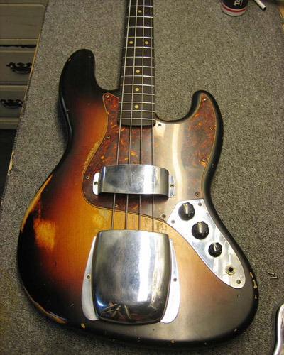

This bass is my model. If I can approach this, I will be very very happy:

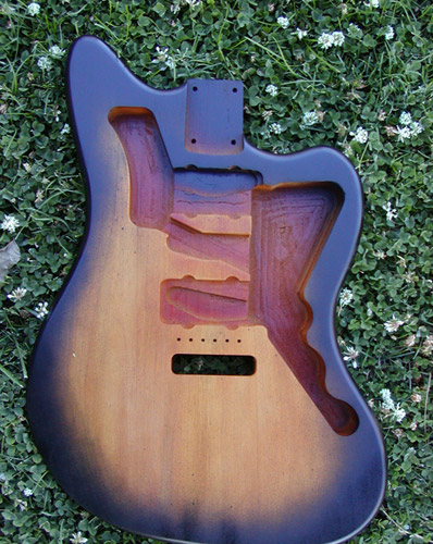

PostPosted: Mon Jun 18, 2007 4:13 am
Posts: 4820
I'm up in the air about this. What do you think? Should I sand and try
again? I'm asking for a critical look here.
I don't know if I have enough amber left to get another coat on if I sand.
What I've learned is that spray cans are NOT the idea situation . I did
exactly as the reranch site describes (hold in center of body, spray
outward), and the overspray floats too far in. It's also very difficult to
control.
[IMG] ../forum/useruploads/JamesOrr/2007-06-18_131340_burst2.jpg[/
IMG]

James, I see what you mean. It doesn't look like the spray can is
atomizing the lacquer very well. Have you sprayed the red on yet? I
wonder if that would blend it in a little better???

I sanded it again today---definitely the last of brown though. I may
shoot them an email tonight to see if they have any further suggestions.

PostPosted: Mon Jun 18, 2007 1:38 pm
Posts: 734
James, one thing I do is to hold the guitar above the spray and spray upward and outward. This way you won't have any overspray or spit marks in the lighter areas. Your arm can get really tired this way.
It is important to spray several weak coats of the red in the transition area rather than one strong coat so that you get a gradual color change. This may not be possible with the spray cans. It is possible if you mix your lacquer. I use yellow, amber, light red mahogany, dark red mahogany, weak black, and stong black from the center to the outside. That's only 4 colors of tint with different strengths.
One tough thing about sunbursts is that they are truly ugly when you are spraying the colors on. It's hard to tell if you will have a good burst until several coats of clear are on it. I keep working with the amber and light red until I get a good blend between the center and the outer area.
Hope this helps.
